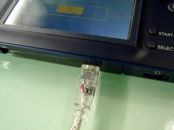

a. Insert the MK5 USB linker to your NDS GBA slot , and use the MK5 USB cable to connect your PC and MK5 USB linker.
The data transfer speed around 1.0M~1.2M on USB 2.0 port. For guarantee the data transfer quality, please use the MK5 USB cable connect to your mainboard's USB port directly, don't use any USB HUB or USB extension cable.
b. Hold the "L" + "R" + "UP" and turn on NDS till you can see the mk5 logo appear (don't release these 3 keys), and press "A"+"B" (now "L+R+UP+A+B" 5 keys are held) ,NDS will start to run MK5 ;
c. Then you will see this screen , and the windows system will detect a new removable driver (MK5 USB disk) is inserted , like a USB pen driver :

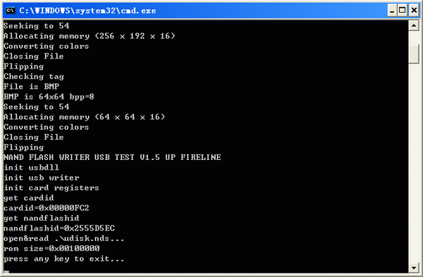

a. Now open the mk5 menu CD, go to this folder: "x:/MK5 serial/MK5 8G & 16G GIGA Cart/Driver/MK5_#1_DownGrade_V1.22F" ;
b. If your MK5 is 8G, then run the "MK5-8G-format.bat" , if not then run "MK5-16G-format.bat" ;
c. You can see the follow DOS window appear, when you see the "press any key to exit..." then mean the menu downgrade is done ;

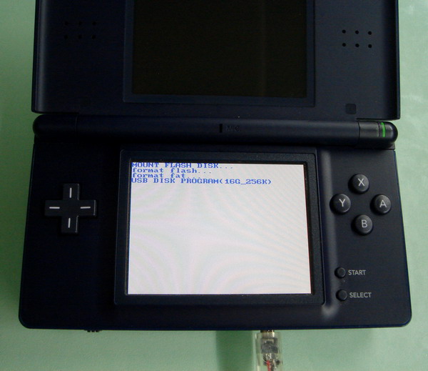

Step [3] ---

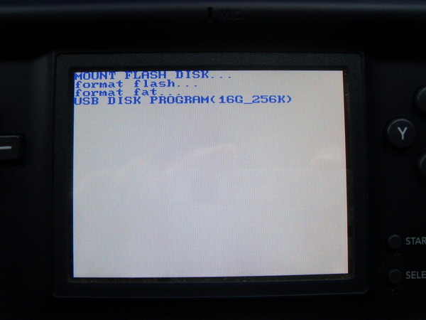

a. Hold the "L" + "R" + "DOWN" and turn on NDS till you can see the mk5 logo appear (don't release these 3 keys), and press "A"+"B" (now "L+R+DOWN+A+B" 5 keys are held) ,NDS will start to format MK5 ;
Step [4] ---
a. When the format complete, then you will see the MK5 USB disk appear on your PC again ;
b. Go to this folder: "x:/MK5 serial/MK5 8G & 16G GIGA Cart/Driver/MK5_#2_Format APP V1.45" ;
c. Copy all files form this folder (include the sub-folder)  to MK5 driver ;
d. Disable the MK5 USB disk from your PC, then turn off NDS.

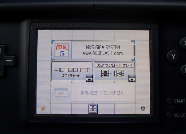

Step [5] --- (If you just get your new MK5 and you see this upgrade file, please follow the below operation and ignore the previous step[1]~step[4] )

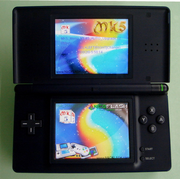

a. Remove the MK5 USB linker, power on NDS, and press A to enter MK5 system;

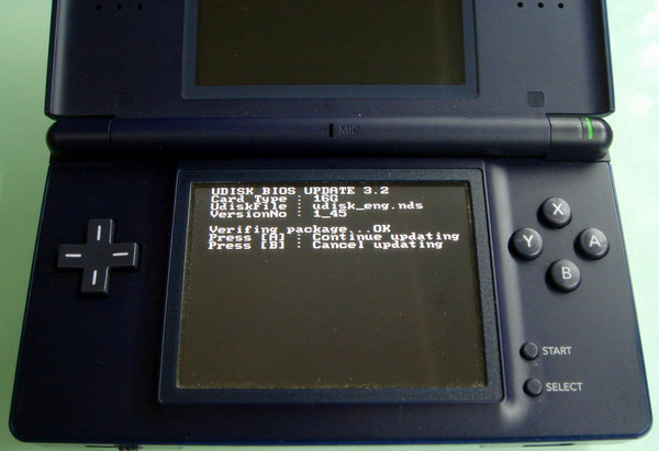

b. Select the "MK5_Menu_V1.45_AUTO_Upgrade.nds" and press A to run it;
c. Press A to continue when this screen appear;

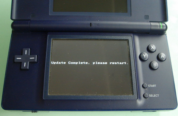

d. When the update complete, power off your NDS;

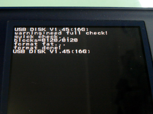

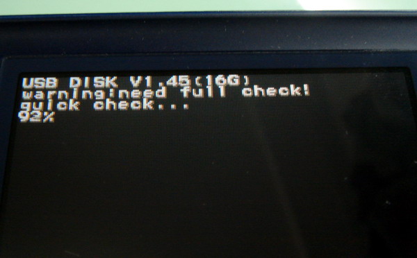

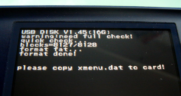

a. Insert the MK5 USB linker to NDS GBA slot again, power on NDS, and press A twice to enter MK5 "USB MODE";
b. If your MK5 have formatted before, then will see the MK5 start to running "Memory Quick Check" ;
c. When it done, you will see the MK5 USB disk appear on your PC;

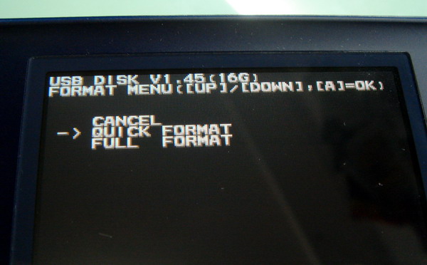

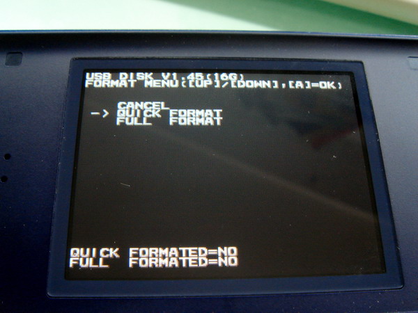

d. If the MK5 is not formatted before , it'll appear this menu, please select "QUICK FORMAT" and press A to continue.
If you can choose the "FULL FORMAT" will be better, but it'll take over 20 minutes to complete, please wait :)
e. After it done, you will see the MK5 USB disk appear on your PC again;

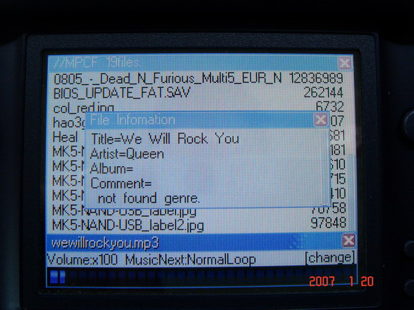

[3] About the music and video play ---
The "x:/MK5 serial/MK5 8G & 16G GIGA Cart/Driver/MK5_#3_Menu_V1.45_&_XMenu_V2.53" have come with the last Moonshell Media Player v1.71 version, it can play MP3/DPG/TTA/AAC/OGG... and can view TEXT/picture ... , you just need drag and drop these files to MK5 then can play!
If you want to generate your own *.dpg movie file, you can unzip the "dpgtools13 for MoonShell Version 1.71.rar" and run for make your own movie, it's not difficult indeed.

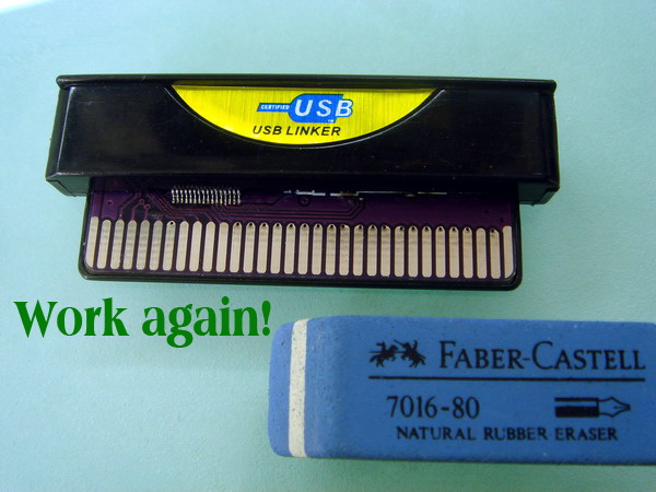

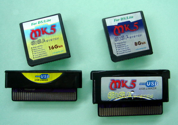

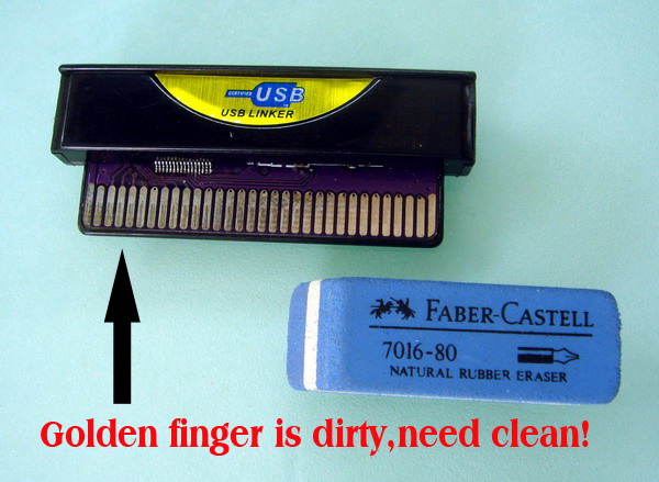

[6] If the MK5 USB linker don't work ---
In 99% case the MK5 USB linker don't have hardware quality problem, you just need use the rubber to clean the MK5 USB linker golden finger, then it'll work again.

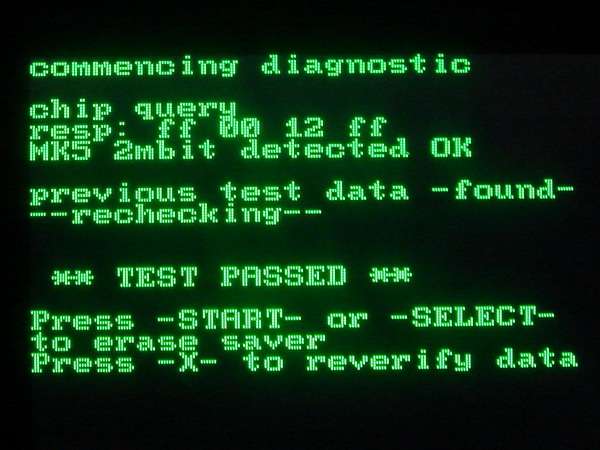

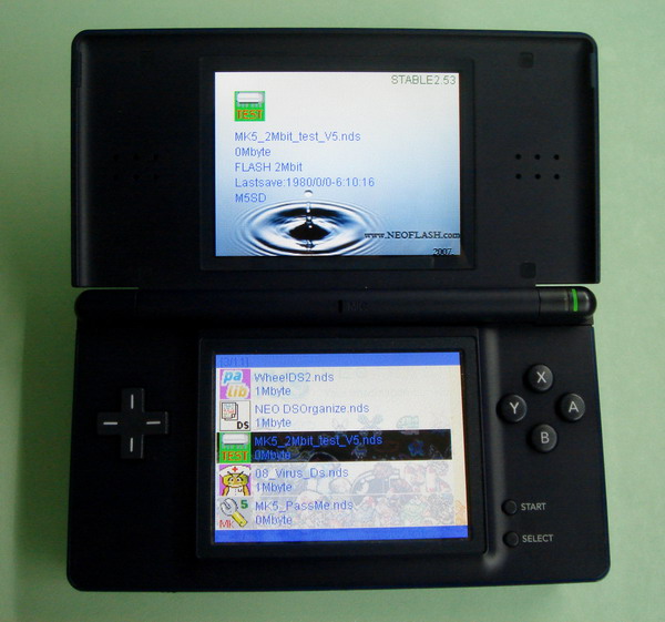

[7] How can i make sure the MK5 SAVE system is working fine?
NEO Universal 2Mbit Save Test APP V5 [June.5th 2007]
Suitable with : MK5 serial
Purpose : test the 2M SRAM ( EEPROM ) working status
How to use:

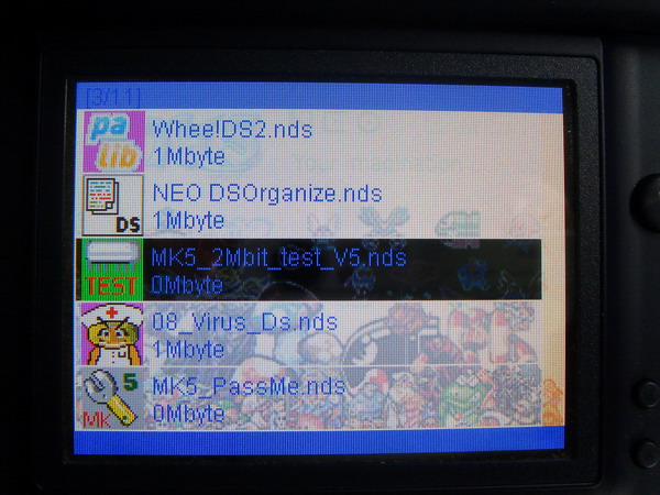

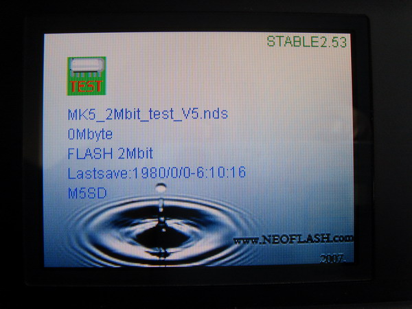

[1] Run this APP from any slot-1 or slot-2 cart, if run on MK5 cart, please make sure the save type is set to "2M" mode BEFORE you start to run it.
[2] Press any button to test the 2M memory,if everything fine,then NDS will show "TEST PASSED". And you can press START or SELECT to re-test it.
[3] Now you can re-power on and run this APP again, it should can find the previous test data and verify it, if everything is fine still,then congrats, your 2M save chip working great :)
download :  http://www.neoflash.com/download/NEO_Universal_2Mbit_Save_Test_APP_V5.rar

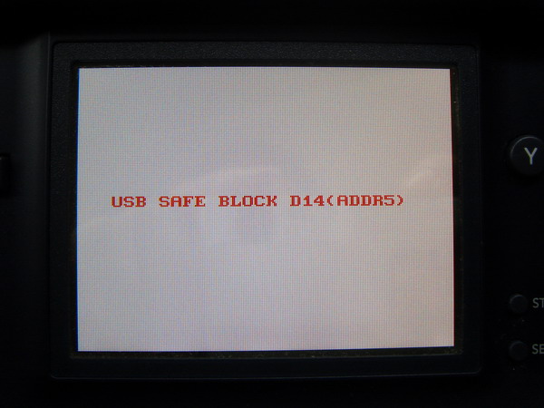

Offline ftwd
Help help help!
I got as far as step 3 now all I get is a blank white screen.
The DS wont start formating.
Agghhhh.
N
Help help help!
Agghhhh.
N
if your MK5 is new 2008 version, you don't need follow this guide, you just need hold START+SELECT when you power on your NDS, then you will see the MK5 format screen.
then you just need format it (suggest the FULL format),then you can goto step[7] directly, to finish this upgrade action.
