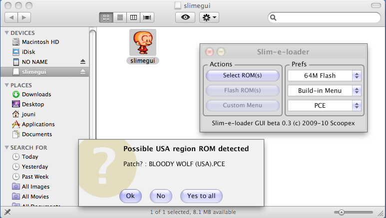

Another and hopefully final beta (v0.3) of the Slim-e-loader for testing. Download the .dmg http://deadcoderssociety.net/pce/dl/slimegui_beta_v0.3.dmg. Few release notes below:
  • Detects USA roms and tries to patch them to "region free".
  • English and Finnish locales included.
  • Improved USB code, which should now handle "cancel" and errors better.
  • Partly tested TG-16 support.
  • Supports 64M and 128M carts but not the recent save RAM feature.
  • The build-in menu is still the good old v1.03 (c) neoflash.
  • Requires 32/64 bit Intel Mac with OSX 10.5 or better.
Note that the PCE/TG-16 switch defines the target machine type where the flash cart is going to be used. The switch does not have anything to do with the JAP or USA roms. So, for e.g. CoreGrafx select "PCE" and for TurboGrafx-16 select "TG16". The USA rom detection algorithm is rather trivial and can currently only find & patch one type of region detection code. So far that has worked for all of my USA roms.
A screen shot below:
I have tested v0.3 in my 64-bit IMac and MBP, and 32-bit MBP all running OSX 10.6.x. I also tested against 64M and 128M carts I have. Unfortunately, I only have CoreGrafx.. Needless to say, this works for me and if it fails for you, your loss..
The source code will be released once I get a good idea how to package everything.. The code is supposed to be portable (GUI and USB use cross platform open source libraries).
