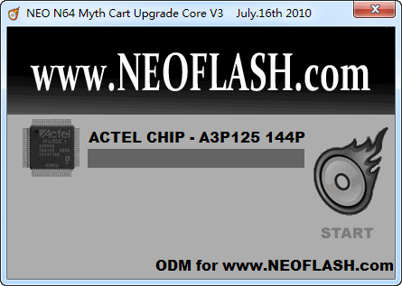

the Neo N64 Myth cart firmware v3.0 released
« on: July 17, 2010, 10:21:28 PM »
history:
[1] Add the function for return to menu in the game
[2] Fixthe neo2 cart ID check issue
[3] The current V3 CPLD ID is 0X83
CLPD V1.2 value is: 0X81
CLPD  V2.0 value is: 0X82
this version is very close with the FINAL version already, all hardware function is stand by.  ~sm-78.gif~.gif
download: http://www.neoflash.com/myth/NEO_N64_Myth_Cart_Upgrade_Core_V3.rar
