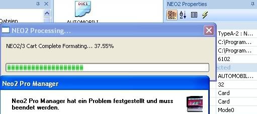

After receiving my N64 Myth with upgraded core v3 (thanks to sanni), I wanted to test the new NeoN64Menu v1.2 from ChillyWilly. Unfortunatelly the Neo2 Pro Manager 1.03 shows up the well know USB Time Out Error! And not after a short while. It flashes my 1024M Neo2 Lite card for about 30 minutes and then stops with the USB Time Out Error. Whatīs interesting it stops everytime at the same percent number...
Then I tried to do a complete reformat. But after about 90 minutes the program crashes leaving a windows error message.  :'(
« Last Edit: August 07, 2010, 02:24:49 AM by stefan_iro »

Offline ChillyWilly
  • Posts: 1491
There was an update to some of the dlls in a post on page 2 (I think)... did you copy those over?
Offline stefan_iro
  • Posts: 191
  • Itīs a me, Mario
OK, I reformated the N64 Myth and Neo2 Lite with NEO2 Ultra Menu V3.04. Then I installed Neo2 Pro Manager 1.03 (without the .dll update) and burnt N64 Menu v1.4 to it. Now it works fine!  ;D
