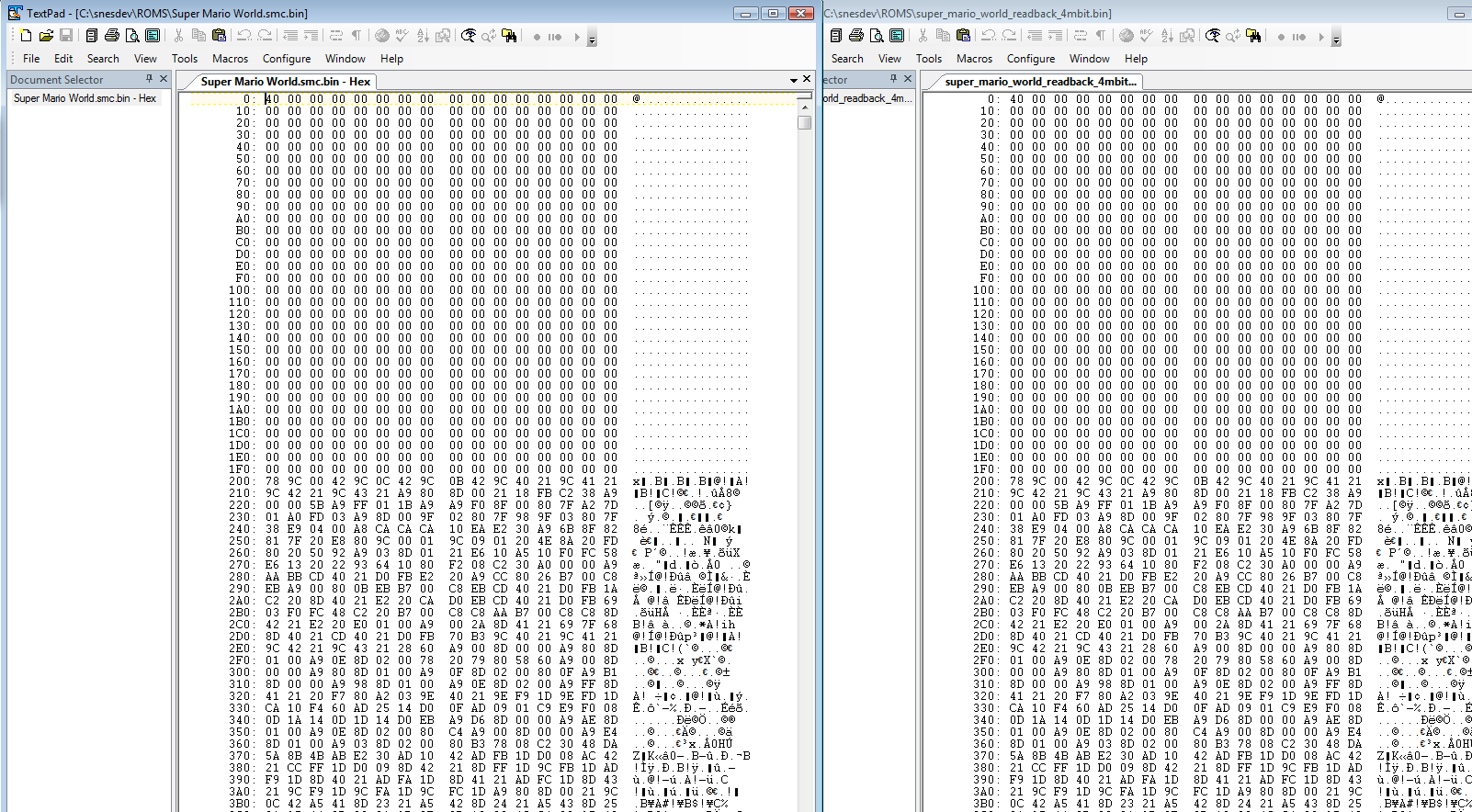

This is what I get if I burn Super Mario World to the SNES Myth using the Manager and then read it back:
On the left is the original SMC file, and on the right is the data that has been read back from the Myth. As you can see, the 512-byte header is still present in the data read back from the Myth. You need to get rid of this header before burning the ROM, as I've mentioned before. In fact, removing the header should be the first thing the Manager does after opening the file, since the header is only intended for old floppy-based copiers and thus is useless to both the Manager (including the plugins) and the Myth menu.
