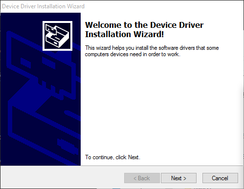

The new win8 and win10 has make some trouble to end user when they try to install the SL4/SMS4 driver,so here we give out the step by step installation guide.
Now, we try to install SL4 in win10 x64,follow me.
[1] Right click the Neo Manager EXE file, and choose "Run as administrator" to run.
[2] Click "Next"
[3] Click "Install"
[4] Click "Yes"
[5] And "Next"

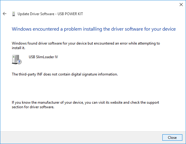

[6] Ohoh......you can see trouble appear, SL4 driver install failed!

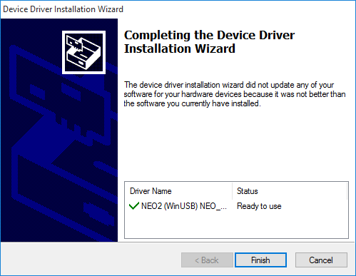

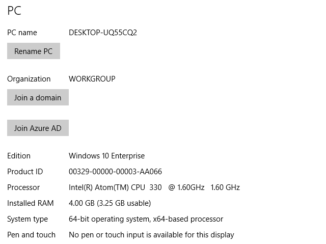

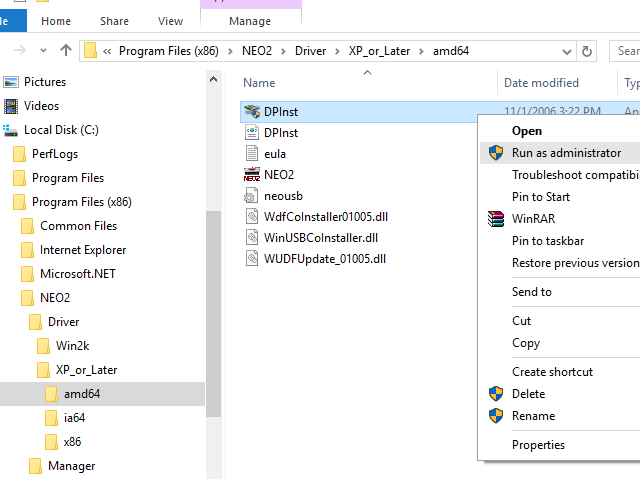

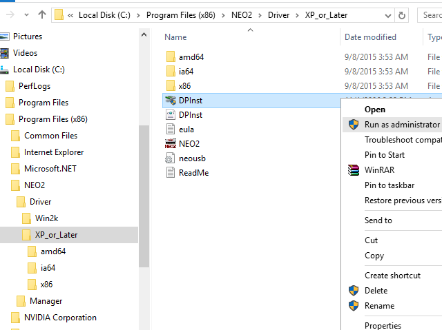

[8] Now goto "C:\Program Files (x86)\NEO2\Driver\XP_or_Later\amd64" , right click "DPInst.exe" and choose "Run as administrator" to run ,try to install SL4 driver again.
For some other special CPUs, maybe you need choose "C:\Program Files (x86)\NEO2\Driver\XP_or_Later\ia64\DPInst.exe" this file to run.
If your system is 32 bit, then you need select "C:\Program Files (x86)\NEO2\Driver\XP_or_Later\DPInst.exe" this file.

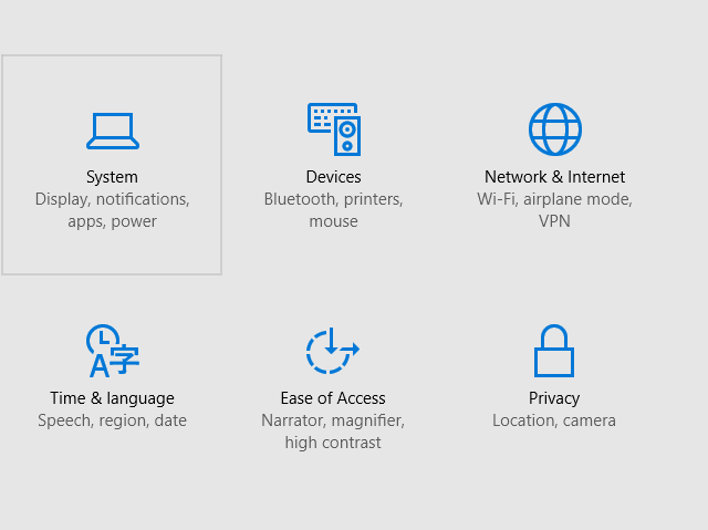

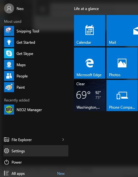

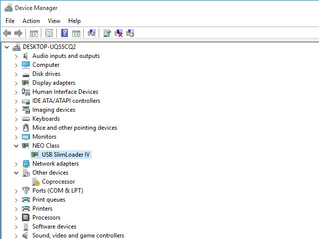

[10] OK, now start to install it through a little complex way. Click STAR icon and select "Settings"

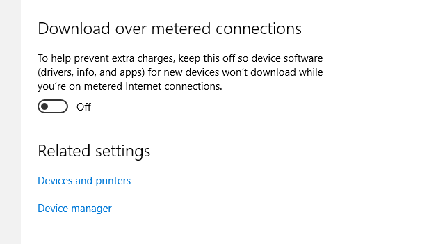

[11] Click "Devices"
[12] And click "Device manager"

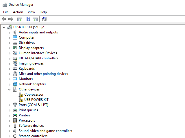

[13] Now you can see the SL4 device show as "USB POWER KIT" and the status is driver not install complete yet.

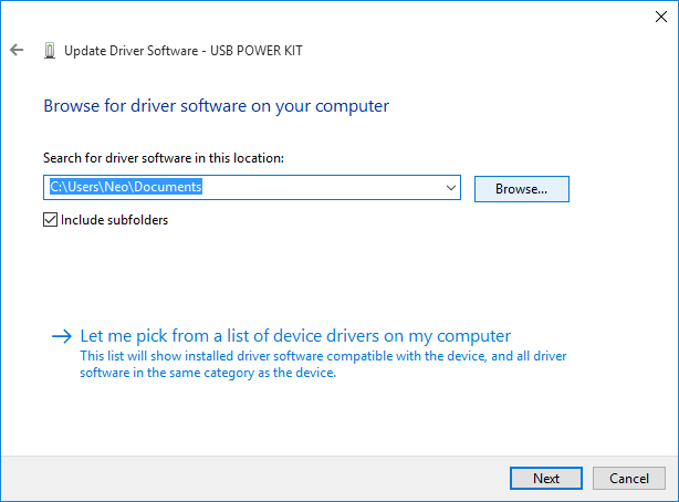

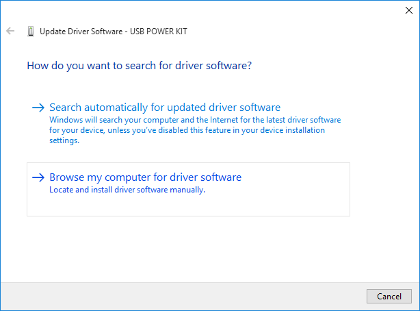

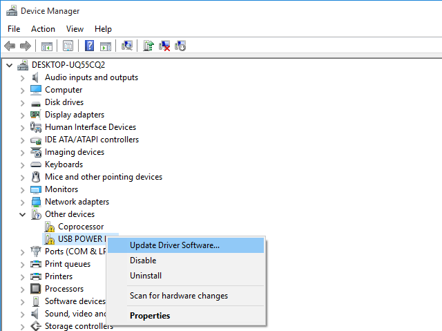

[14] Here we try to install this driver by manually. Right click and select "Update Driver Software"
[15] Select "Browse my computer for driver software"

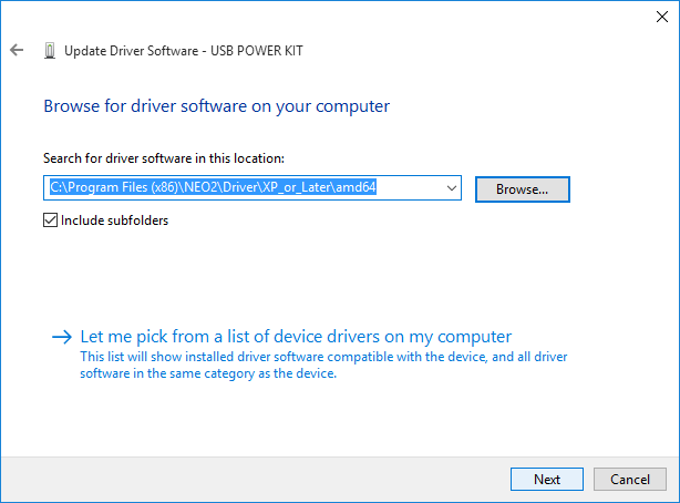

[16] Click "Browse"

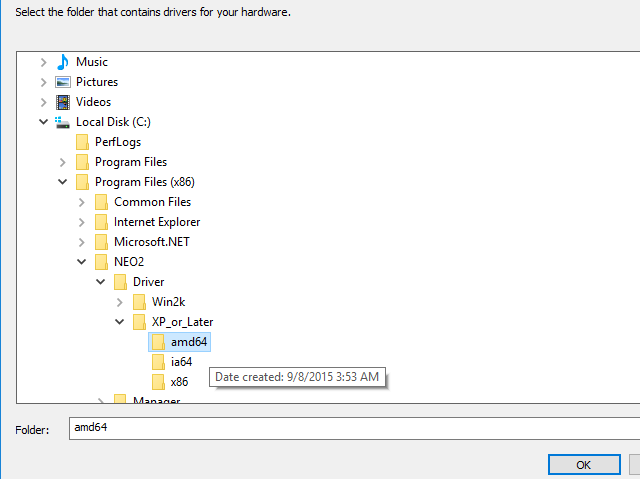

[17] Goto "amd64" folder
[18] Click "Next"

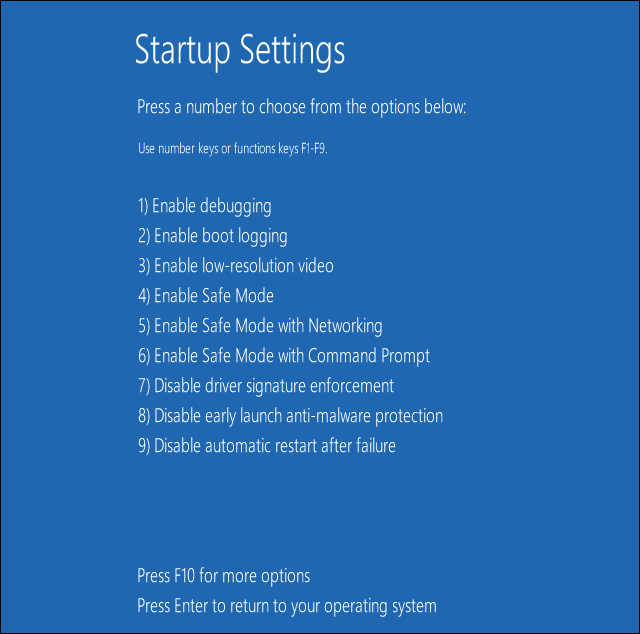

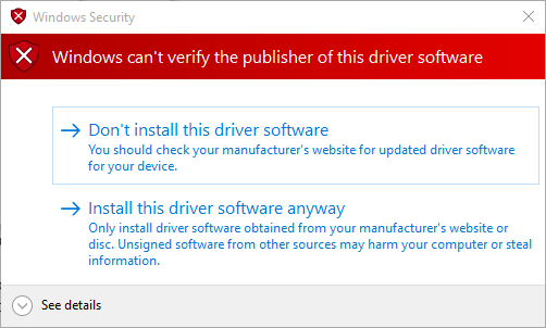

[19] You will see this digital signature warning message, we have to disable it to make the driver installing workable.

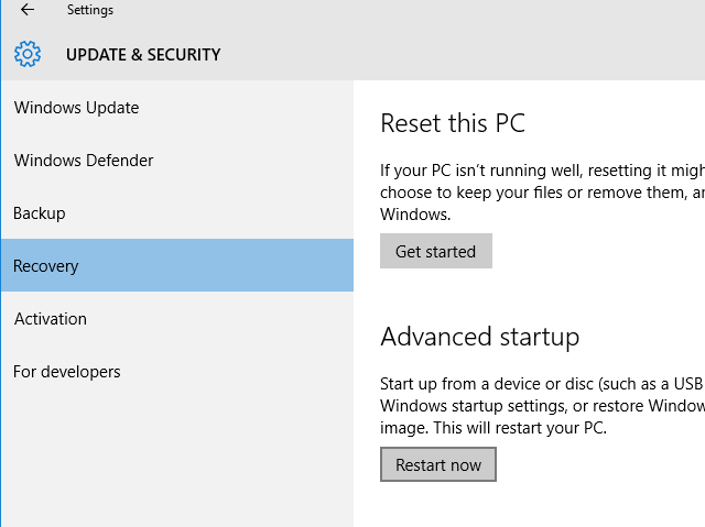

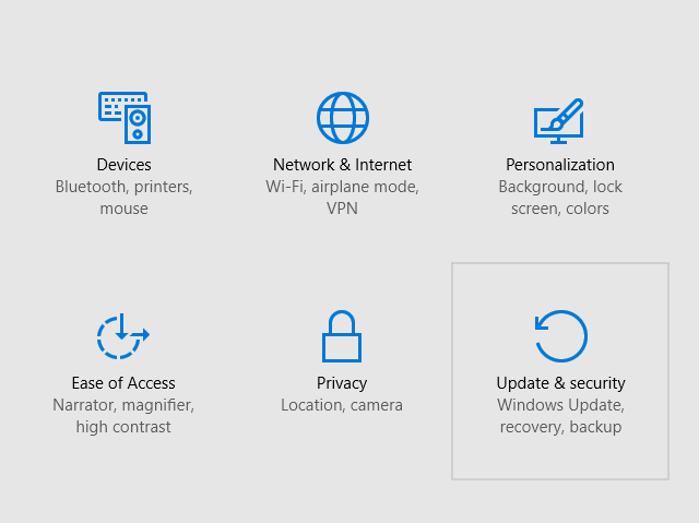

[20] Click STAR icon and select "Settings" again.
[21] Click "Update & security"

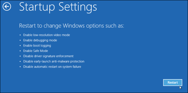

[22] Click "Restart now"

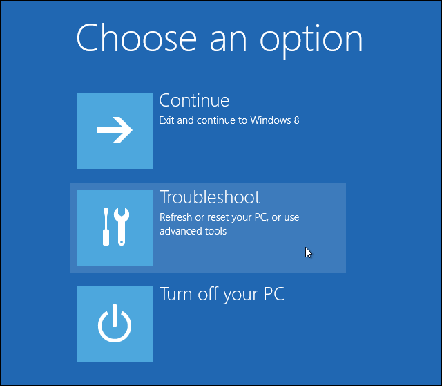

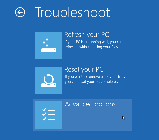

[23] Click "Troubleshoot"
[24] Click "Advanced options"

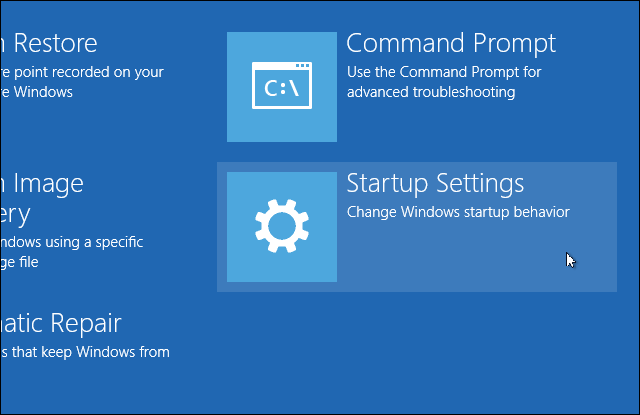

[25] Click "Startup Settings"
[26] Click "Restart"
[27] Press "F7" or "7" to start win10 again.
[28] Then, repeat the installation step [10] to [18] again, you will see this warning message, click "Install this driver software anyway"

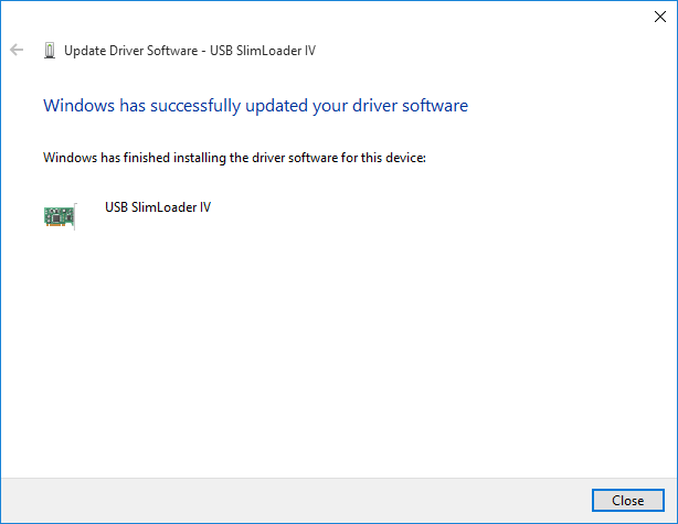

[29] bingo!
Now you can see the SlimLoader IV have been install succeed!
